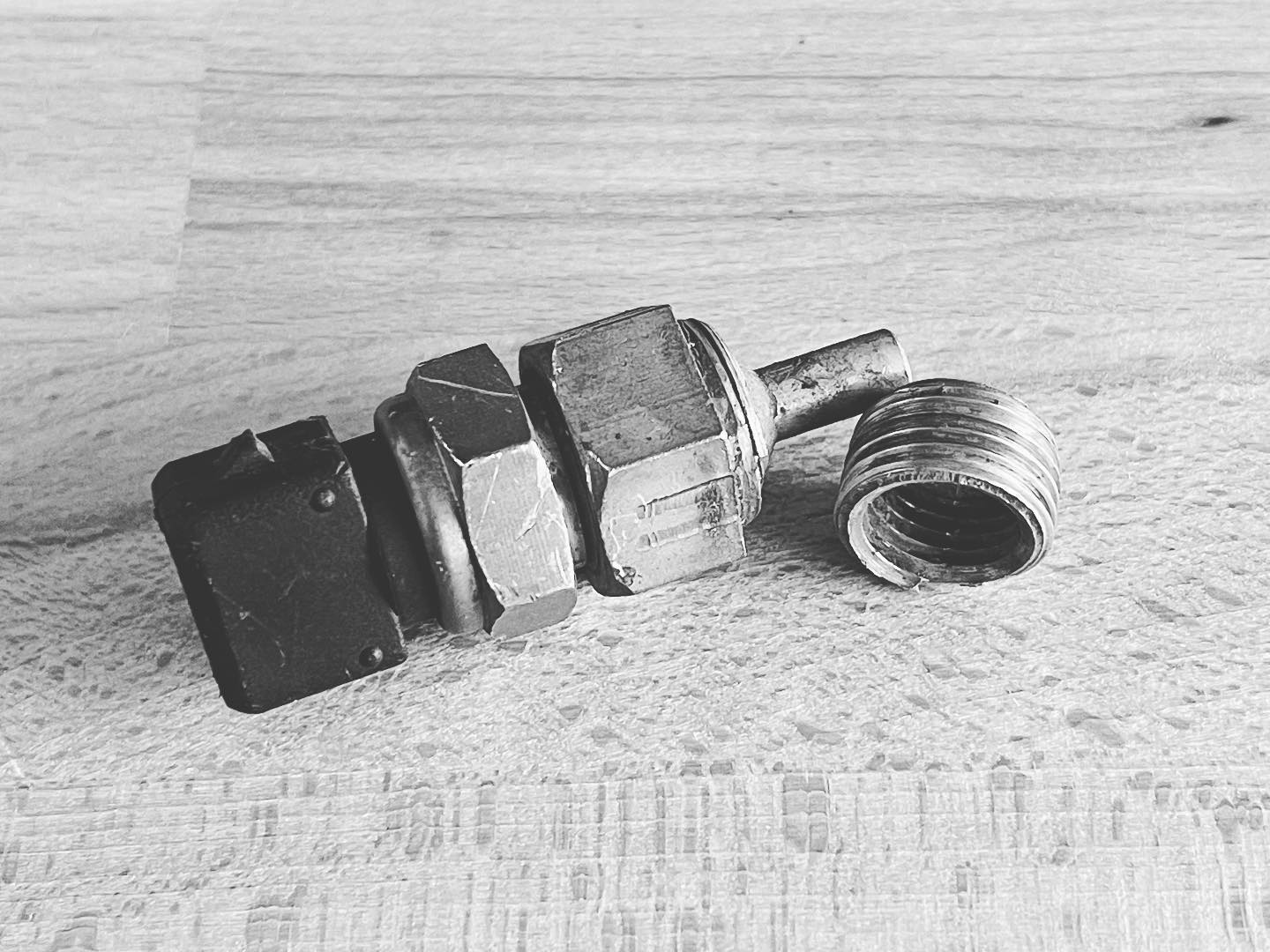

The other day I was flushing the water out of my block as it was rusty as fuck however when taking out the temp sender this happened *oh well*.
The problem here is that apparently trying to source a 5/8" UNF (m) > 1/4 NPT (f) is practically impossible, at least this is my experience so far. The one that snapped we made.

Sorry, the standard mini temp sensor thread is 5/8" UNF i assumed this was a known thing so my bad, the new sensor is 1/4 NPT
Problem is the senor and mini head thread are almost mm identical once the threads are in so i am thinking if i get to close again the same might happen. So i am thinking i need to have a bigger top on the end of the adaptor the sensor will go into so they the thread dont overlap. Not sure if explaining to well :/
I mean i could create what i did last time from an ebay or MS adaptor but the same will happen.
Maybe it is a case i make it to be disposable lol
