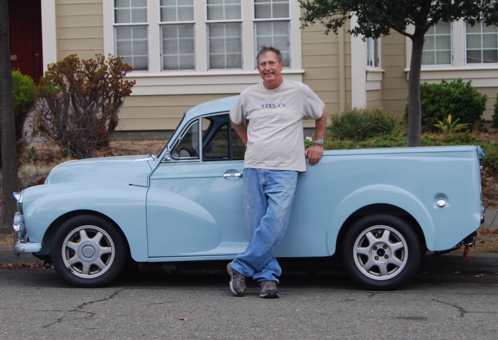

Not sure if was a member in the previous site, maybe, anyway I'm here now.
Not qualifying as a Mini owner, but an inline A---1275(Midget) in a Minor '61 LCV. I've just rebuilt the engine stock bore, new HC pistons, a "fast road cam", that's basically a Metro Turbo cam (256/268) and a set of 1.5 RR. I have a lightened flywheel (12lbs) and a T-50 five speed. I've scored all the parts for a turbo setup from a Metro Turbo for it but want to use a better turbo than the T-3. My son suggested a T-4, but that's pretty old now, maybe a 1274 is a bolt on (?). I'll keep the boost pretty low for longevity. Open to all suggestions for a street car...
Otherwise, have 240SX discs all around, 185 70 tires on 5.5x14 NX alloys, 3.90 diff., Whiteline HD sway bars on both ends, lowered 1 1/2", poly bushings everywhere. Had an issue with axle tramp before the rebuild so I maybe need traction bars.

A T4 would be atrocious, most folk these days use the GT1752 with very good results, there's a wealth of knowledge and experience at you finger tips with the search button.

Hi Gene, You're in good company for silly ideas, welcome!
That minor looks pretty good.
So yeah, don’t do the T4 - or the T3
Just get an GT1752 - or a Chinese equivalent off ebay - or the genuine Garrett 727264-5001S or the new line of turbos like the GBC17-250 36mm

Great car, and another 'wrong way round' engine (I have a Midget) Welcome!
