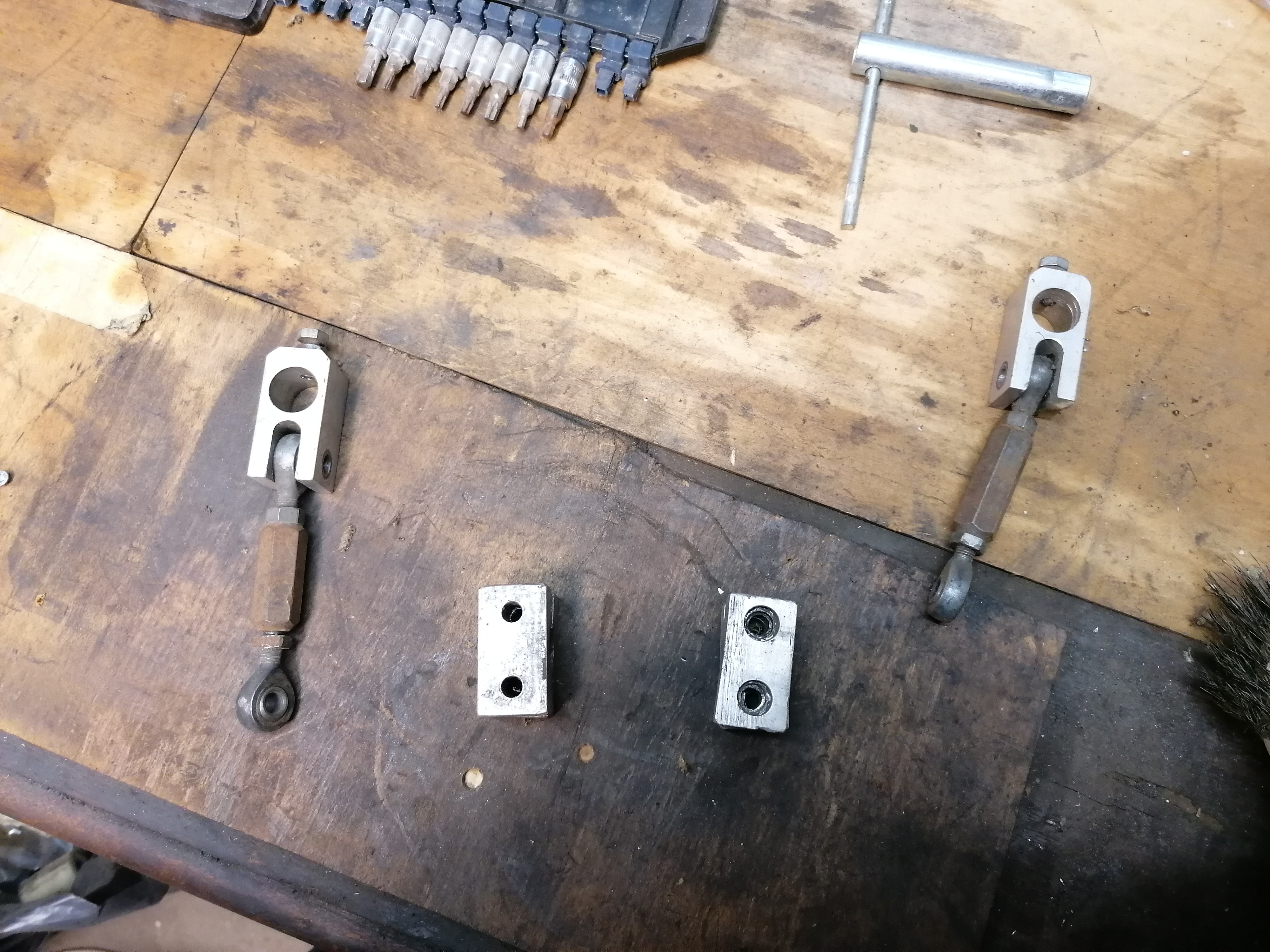

Was cleaning out some boxes of parts I bought years ago allong withe a mini. Never got round to look into all the boxes and as time past by they got further to the back.
So this weekend I looked into them. Mostly scrap but this got my attention.
Part of a anti rol bar?
Front or rear? Where would it attach.
Grts.
Slow response. But yes, front ARB bits.
Drop links attach to the bottom damper bolt (you need a longer bolt.
The ally bits with holes in slide on to the ARB ends. You can adjust the ARB by sliding them along the ARB.
The other bits are just for mounting the ARB on the subframe
