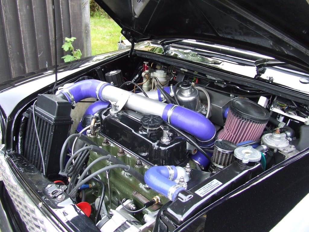

Looking at inter coolers are there any you would recommend for a standard nose mini and running a distributor still? Thank you

The series 2 Escort RS turbo unit fits in nicely and is effective for its size. They can still be picked up cheap enough to.

Second the RS turbo unit.

Thank you. EBay the best place? I have an Audi TT one I got of a scrap but think it’s going to be to big

Try auto doc i got a bmw diesel one for my clubman wont work for you but it was £52 delivered from Germany.......

The problem with the RS unit is now the age, most have had a life already and the good units can go for good money.
There where a few companies that used to make alloy "upgraded" coolers but dimensionally I seem to recall these where bigger.
The stock unit was a snug fit in a round nose bay.
