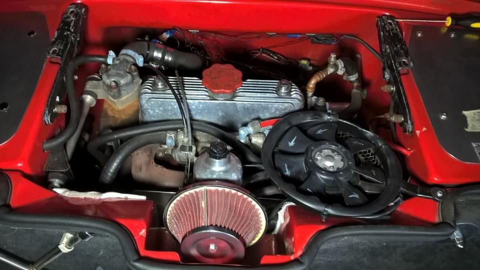

HI,
Edited by Gustywinds on 28th Dec, 2021. |

"To get best performance requires port injection and use of software for the controller specifically designed to cope with the Siamesed ports. This software is available for the Megasquirt 3."

I thought polestar ecus also provided MPi fuelling too? They have it as an option in their fuelling menu. |

There may be a few that "do it" but how ?

On 2nd Jan, 2022 Rod S said:
" The rover Mpi is port injection, it's just that the ECU/firmware/software isn't user programmable. The manifold, injectors, fuel pump however is easily controlled by another ECU. Unless you want to go through a big learning curve on siamese port injection, you would be best doing a "wet manifold" setup. Not with the SC software as IMHO it is awful but their manifold/throttle body is good and once you have a decent manifold and throttle body (there are others than just the SC version) you can use pretty much any ECU to run a wet manifold (batch injection) type setup. Thanks Rod. I am leaning towards a MS of some sort with either a Rover MPI setup or the SC one. It will depend a lot on what will fit. SC haven’t replied on requests for sizes on their kit but I guess that’s not surprising at this time of year. Have sent a mail of to Megasquirt asking their advice. |
