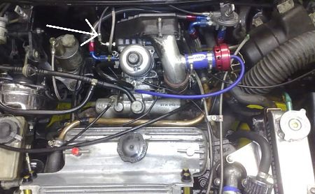

Dived a bit deeper into the bleed valve knowhow.
I ran into this picture in a different bleed valve topic.
Sorry for lending your pic, but it’s for a good cause.
My enginebay is quite full it seems that I have not been looking well enough.
I thought the t-piece on this pic was the inlet on the wastegate actuator, but it’s actually the t-piece on the turbo right? And the inlet on the actuator is somewhere hidden under it.
I will have to block the line that went to the solenoid (top of the t-piece) and put the bleed valve between the t-piece and the wastegate actuator?
I really wonder how I’m gonna reach there…. *frown*
