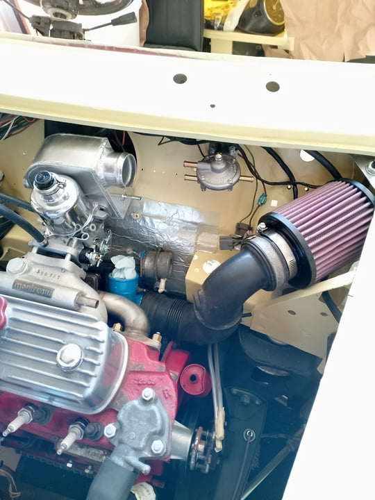

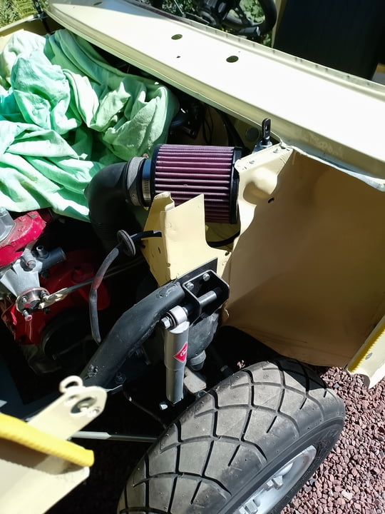

I installed the new air filter now and end up with the place seen on the pics.
From your experience, is this corner maybe not the right place for it?
For info, I'm using the bonnet from an ERA with the air venting holes.
In an ideal world you would want it in the cool air at the front of the engine.
However I’ve run mine there for years without a problem.
The only other issue you may find is fitting your wiper motor in as it is in the same location.
What is that pipework from?
It looks useful.

great, thanks for the info.
I thought of moving the filter into the wheel arch, but if it runs good in the actual position I will leave it there.
So far I didn't think about the wiper motor. Did you find a solution?
The pipe between turbo and airfilter is the original pipe from a SAAB 9-3 YS3F B207
It will run fine there, if it helps.
I moved the wiper motor inside, but it wasn’t all that great.
I’ve just moved that back to the standard position, and now I have the challenge of trying to get the air filter to the front of the engine bay.
I wonder with the pipework you have, if the wiper motor will fit underneath it without touching?

Yes, that helps.
I can check the fiting of the wiper motor more closely this weekend as I need to find my wiper motor in one of my part boxes.
Ralf
60 Posts
Member #: 11964
Lindlar
just checked if the wiper motor fits.
Unfortunately it fits not.
