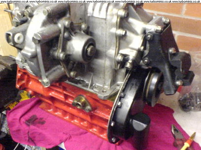

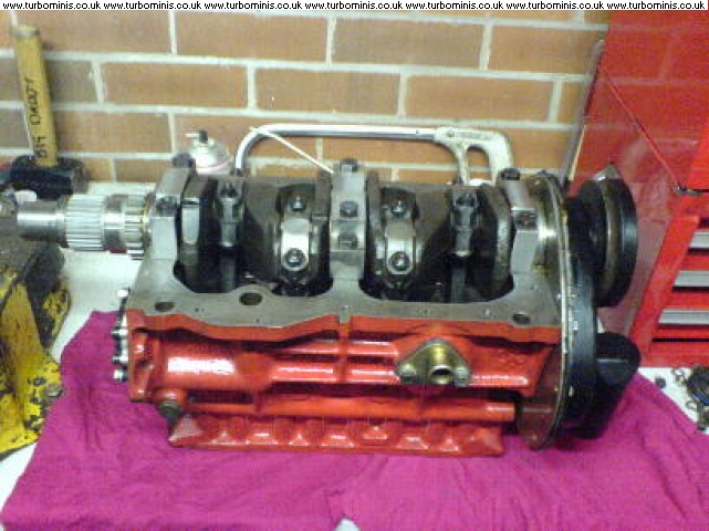

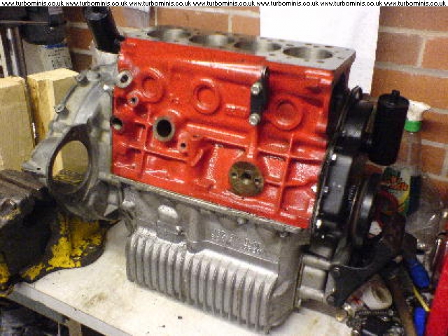

Engine bottom end. BFH for dealing with naughty computers at left hand of photo........

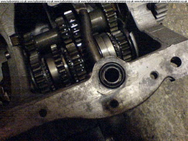

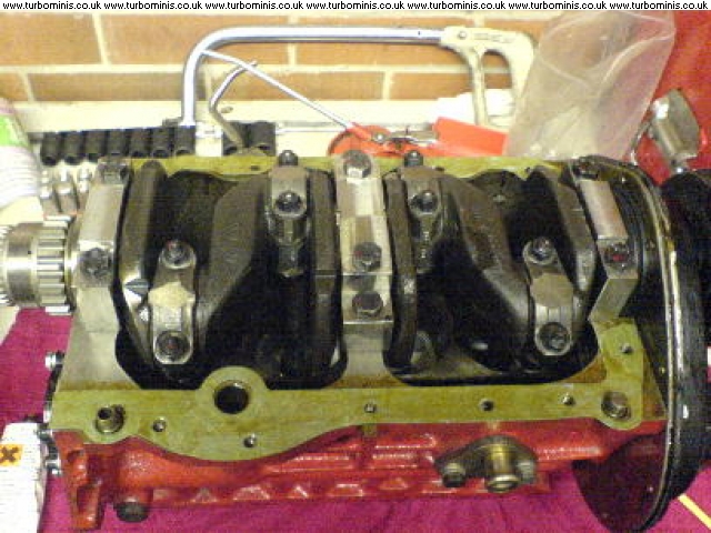

Gasket face coated with Wellseal as mentioned in another thread.
Gearbox O ring in place-held in with a dab of RTV silicone

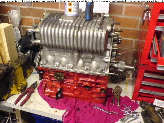

Gearbox placed on top of block
Bolted up

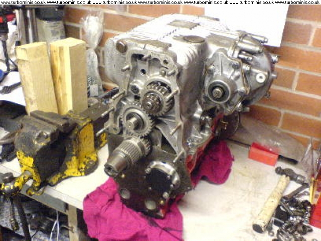

Drops

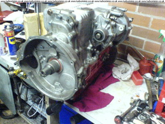

Flywheel housing bolted up
Turned Upright

nice work tom!
6297 Posts
looks ace! *happy* get it in the hole!!

lovely wellseal !!

I hope you used a gasket between the box and block as well....
Looking good...
Yes I did use a gasket, the second picture down showing the wellseal, is actually wellseal on top of the gasket material!

I hope i'm not looking at the original 'putty steel' bolts between block and gearbox there???
Certainly not Dave, I threw the originals made from sponge cake and fitted high quality 1/4UNF bolts from Namrick instead.

.... whats wellseal?
It is a non-setting gasket jointing compound, similar to Hermetite and Hylomar etc.
The main difference is however that Wellseal DOES NOT leak, and hylomar and hermetite in comparison are sh1te!
I tried Wellseal on the recommendation of my engine machinist about 6 years ago, I will never use anything else now for close fitting gasket joints. It is a quite thick liquid, I tend to spread it with a small brush for best effect.
Cheers, I'll give it a go. always used locktite 574 but thats not non setting.
