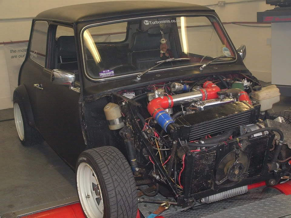

i've got a metro rad and a 2wd cossie cooler in my clubby front, although its a flip front.
Keans doing the same in his normal clubby though, metro rad with a couple of bike fans mounted on it, with a cossie cooler behind the grille. They fit perfectly, look like they were meant to be there *wink*
You've got a clubbie, that means that everything fits neatly in the front.
Cossie 2wd intercooler on top of the rad below... ( Of unknown make :) )

cool, mines a flip too. is the cossie cooler narrower that the RST? the two side by side cause overlap thats not in the airstream.
Nick
4828 Posts
Member #: 154
Midlands
here you go dude, its not the prettiest looking, but it works which is all i care about at the minute.
