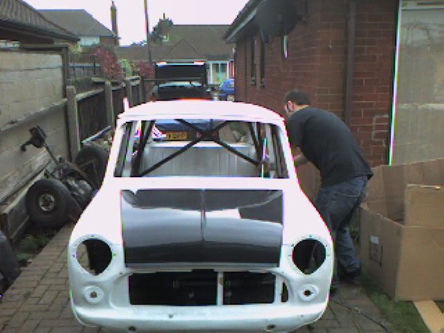

not too interesting but figured i'd pop it on here anyway. Here is where i am at the moment, lovely primered shell complete with visible weave carbon bonnet (just rested on in the photo as i havent drilled for the bonnet pins yet) and the cage has had its test fit (which it why it is on the piss in the photo), engine is in a few bits (head is with turbo hogster) and being hammerited, and my doors have just been flushed (ready for me to fit my chavvy remote door popper kit)
clearing out the garage soon hopefully so i can paint the engine bay, and get the engine on the subby and get the shell rolling again, also going to paint the interior so i can then bolt the cage in, and fit windows/doors so it is watertight and winterproof (as winterproof as a mini can be)
then its just build build build and bolt bolt bolt all the bloody bits i have bought over the years (as well as purchasing and fitting the ever controversial bolt on plastic exterior styling items :p)... i am growing impatient i have to say! :)
2 things i am not looking forward too .... 1) fitting roof lining and 2) wiring, oh well, all part of the fun *happy*

is it wise to leave the headlining out? i can imagine it being horribly noisy in the rain, lthough a forced induction a series aint the quietest of things :p
think i will put up with the hassle of the headlining, just for the luxury touch :)
Tom, it only took you a day? was that a new loom complete with tags to tell you what wire was which? i'm considering buying a new loom to make things run more smoothly.
ace, what colour will you be painting it?
im sure you (or whoever that person is) was moving about as the pic loaded
headlining really hard i am a fussy wanker so spent 4 hours doing mine and still cocked it up
