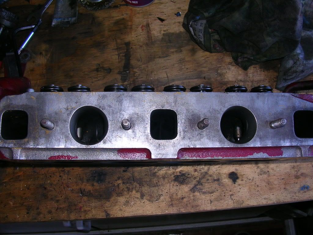

here is my head

You think the Kent 500 (mgMetro profile) was lumpy? And you're going for a ph3????
Woweee, you're in for a surprise!
red the phase 2
fire this in and time it at 108 deg & 1.3 rockers
i can assure you its a fantastic cam!
none lumpy ticks over like a small tiger & when this comes in! with the turbo its like a hungry lion as Fabrice once described.*wink*
its so true
i bet you will be throwing the phase 3 over the hedge once you have run this.*frown*
Please keep us posted *smiley*
