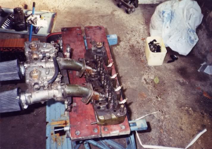

Someone posted this picture on another mini forum asking what it was. I'd be interested to know, so I thought I'd ask you lot.
Any ideas?

A Modified 1275 head for semi downdraft,Slark etc still do them.Carl Austin has done his own with great success.(similar)
As for the carbs they are "split" 40's or 45's, a popular mod for gaining a good flow that is more direct.
Grannies/eggs i know for some.

THB it is old hat........
cost loads and sometime unreliable due to weepage.

looks like a lot of work, Did Carl see many gains? is it really worth the 8 port?
If you have 4 inlet ports, any mod / money is worthwhile. If you have 2 inlet ports - you'll always be ultimately limited.

Surley two ports are two ports? looks good though, think slarks play around with this sort of thing..
