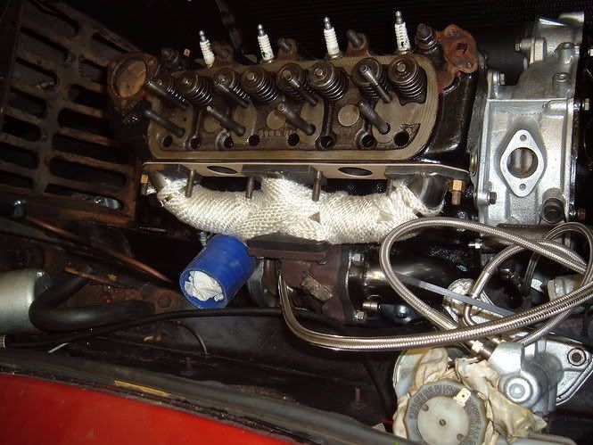

Pic of the turbo in situe, there is more room to be had because i hadnt fitted the engine steady at this point.

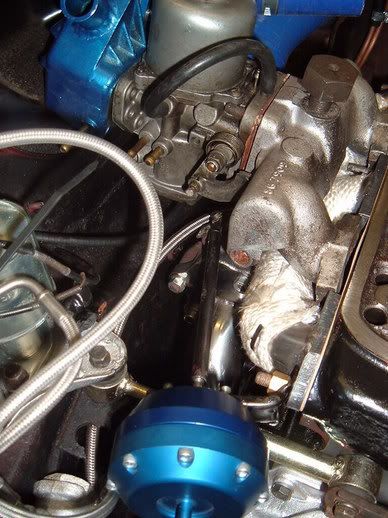

Here is the relocated actuator

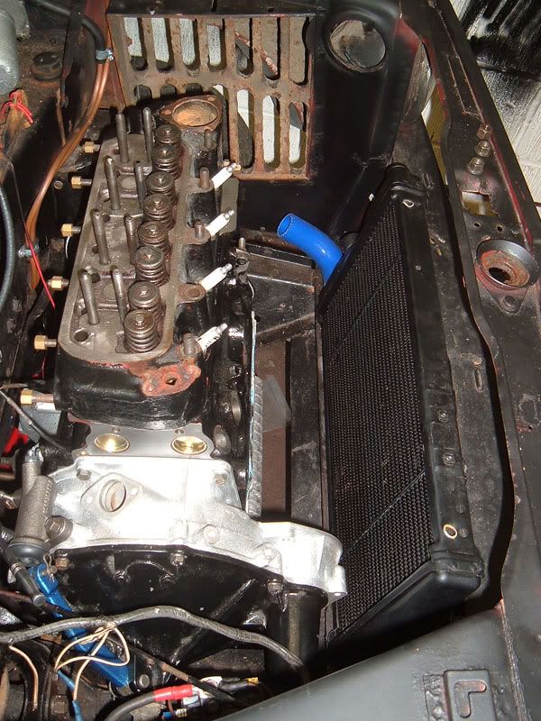

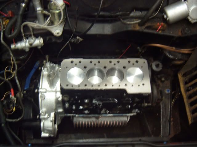

All nice and shiny - but aren't those pistons a little flat for a turbo????
colas
567 Posts
Member #: 102
Pennsylvania USA
No bulkhead box are you using a T2?
Kean
2406 Posts
Member #: 341
aka T2clubby
South Staffs
Yes, using a t2 or t25 colas.
Dave, the pistons are flat top omegas that sit down the bore, Simon has decked the block to suit, bringing the cr to about 8-1.
Waits for everyone to start shouting about squish .......... *tongue*
Don't really know for sure until someone tries do we?!
One comment, that clutch release arm looks seriously bent! If I were you I'd inspect the ball on the end in comparison with a new one, OK the bend "fixes" the problem, but it does not correctly replace the worn parts causing the problem in the first place!
That clutch arm is about £7 from Minits last time I bought one.
Nick
4828 Posts
Member #: 154
Midlands
the ball is fine dude hardly any wear on it, but its a new plunger and release bearing and slave/master/braided line.
We reckon that they must have made 2 different pre-verto arms as a couple of our mates are also running arms the same as that that appear to have been bent, trouble is they're all bent to the same angle/same place etc. i'm really miffed by it to be honest as its too much of a coincidence for em all to have been home brewed exactly the same as each other.
but if it does give us any problems like you say its only £7 for a new un :)
Kean
2406 Posts
Member #: 341
aka T2clubby
South Staffs
Yeah, like bud said, its a manufactured part. I've seen a few of them now, have no idea why they made 2 different ones, when its bled and setup ill see how it operates :)
is that right? you dont need a bulkhead cut out for a t2?
Kean
2406 Posts
Member #: 341
aka T2clubby
South Staffs
Not if you use the mirage stainless manifold setup
£350 of your earth pounds
thanks for the updated picture. that is veeeerrrryyy interesting
Nick
4828 Posts
Member #: 154
Midlands
it all seems to be going really easy so far. i was expecting loads of grief making up oil drains and swapping the actuator over and stuff but its all been plain sailing.
hats off to mirage for the kit, its a piece of art :)

I'm really interested to see how this runs with the pistons being down the bores.
I heard a lot about squish when I was trying to work out how the lower the CR with the 8 port head. I believe there was an 8 port turbo mini racer that ran quite successfully with that setup.
Keep us posted :)
looking very tidy...
what radiator is that from? a mk1 metro?
Kean
2406 Posts
Member #: 341
aka T2clubby
South Staffs
Not sure if its mk1 or 2, but its a non-turbo rad
The turbo one is slightly thinner and the oulet pipes are better placed.
