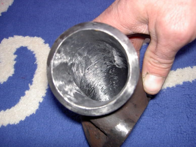

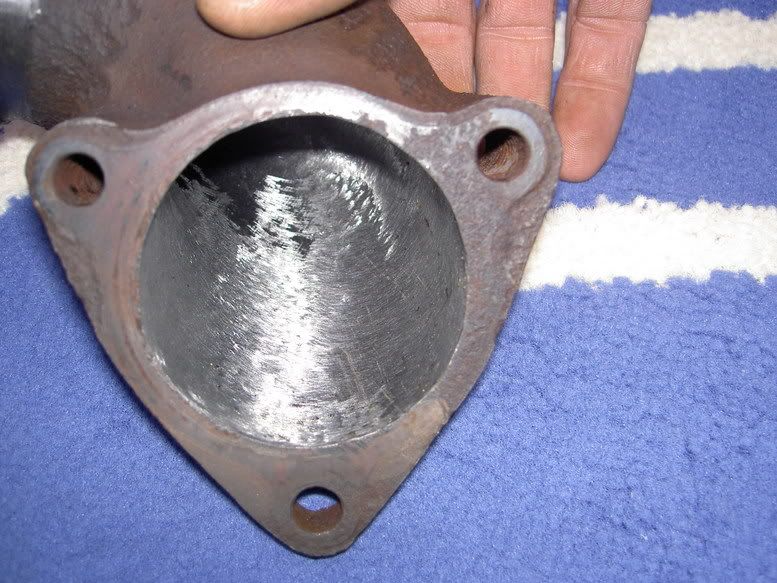

Another BENROSS PERFORMANCE ENGINEERING QUALITY PRODUCT!!!!!!!!
Bored out to match 2" Downpipe,Should see a performance increase

Nice work benross!
yes looks good mate, must have taken you a while.
thanks guys
i love doing them no more than one a week though
i left the mating face to the turbo housing for dangerouse to finish as he is the guru on surface grinding.
Just one thing has any one ACTUALLY tested this mod? or is it a theory might work?
Not knock your work mate, i just wondered*wink*

do you just use a die grinder?

by removing the "bottleneck" it should have a performance increase...the way i see it, it should stop exhaust gases backing up and stalling the turbo just imho though i have never tested it, but anything that allows the engine to breathe better has to be worthwhile, normally the case with N/A stuff, but i am new to turbo`s

On 02/12/2005 11:41:15 T3Tone said:
Anyone know a before and after size comparison!! How much material has been taken out?
On 10/11/2005 20:18:20 nigel said:
What difference will this mod make? as were only talking of a few mm?
Area of stock eblow is (guess) 42mm ID
Area = (PiD^2)/4 = 1385mm^2
Open it out to 47mm...
Area = (PiD^2)/4 = 1735mm^2
1735/1385=1.253
ie a change of 5mm on diameter = a 25% increase in flow potential...
