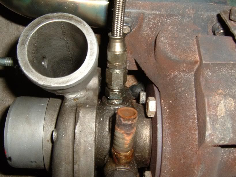

im usinbg a t3 kit that i got from iain which works fine on my car
theres no banjo bolt on mine, i just have an adapter that fits into the turbo, (which i got from earls, do a search and the part no will come up) and a -4 fitting that screws onto this

im not using a banjo, is every one else?
i have this:
just a male to male convertor, and a -4 female fitting on the end of the hose

yes it is, my housing was already threaded but had a bung in it, i removed it and got the fitting from a hydraulic supply place.
since then ive made the hole in it bigger as it was only letting me get 16psi
