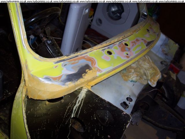

Its amazing what you find under the paint when you start rubbing.

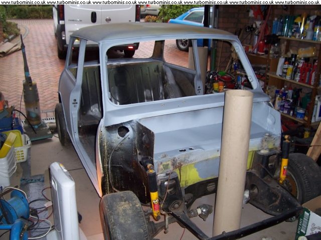

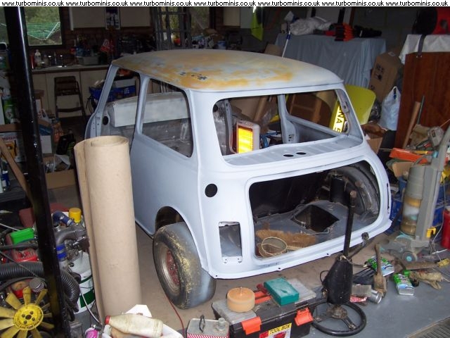

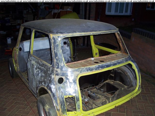

Right Guys - I had problems painting over the greeny yellow top layer of paint as its some sort of enamel based paint - everthing jsut cracks and separates even if you rubbed it right back with 240wet and dry
So I decided to take the shell back to bare metal - Easier said than done!!
This picture shows the shell partly stripped - all metal was rubbed back a with a sanding attachment at 80-grit. However I found it easier to remove the top layer with a wire brush attachment for my angle grinder. This was because when i used my sanding attachment it would clog up as this layer of paint would melt and stick in the paper!
For all the nooks and crannies I used tonnes of nitromores - must have spent a good 40quid on it now!!

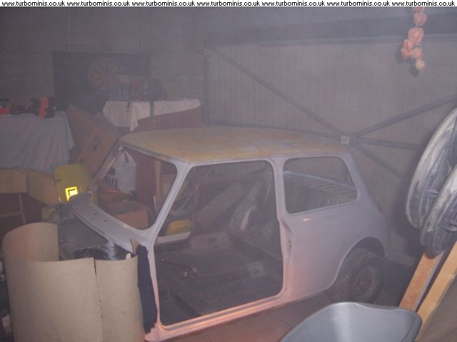

Anywho - once I was back to bare metal I blew a layer of etch primer on
MY head was spinning when I came in from the garage I can tell you!!
The roof has also had to have some filler primer blown onto it as it seems to have lots of small imperfections.
I have just got to decide on a basic non metalic celly colour to spray it - maybe a light blue?
Will keep you posted.
