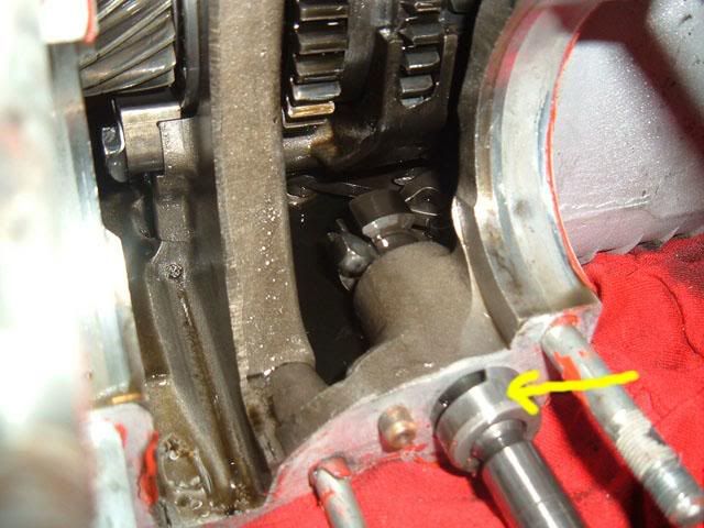

here you go dude. I needed some advice off the dudes on here when i changed mine so i took a couple of pics once i'd done it just incase *wink*
pair of moleys on the selector and rotate anti-clocwise and pull back on it if i remember rightly, till it looks like this:
then what it looks like with the 2 gears locked:

first time I done one i was struggling,till the arrowed bit fell out so remove it completely now
