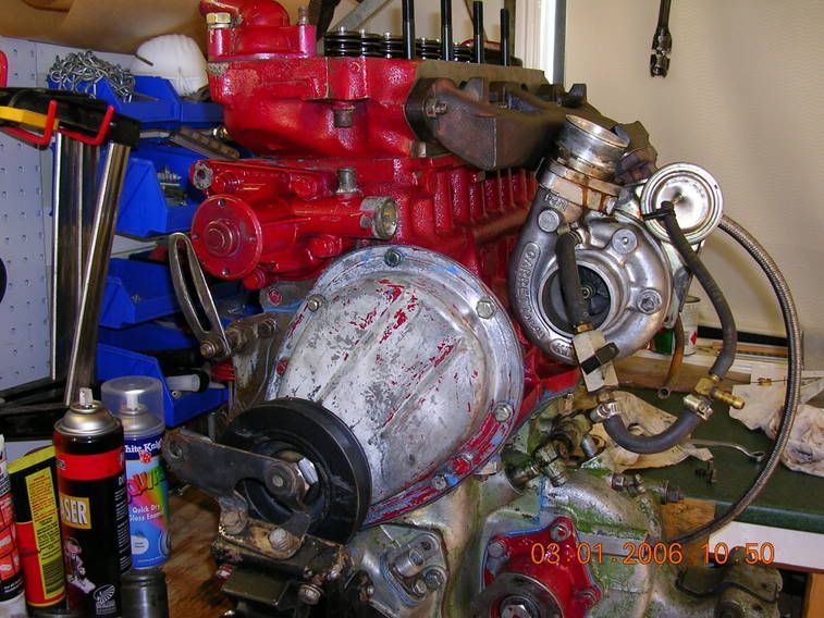

as you may remember i ordered a new ph 3 cam and have just comleted a full rebuild with omega +20, 7.6: comp ph 3 cam big head 31 and 36mm valves and big ports etc etc.
a chap here is Aus being the mini guru has a engien dyno so i decided to get it tuned on that and set up before the install, so two weeks ago we did it and the results were mixed.
it ran real rich most of the day according to the exhaust sniffer but looking at the plugs she was runnign great.
the hp at 10psi was 160 at 7k and 125 torque at 5k and held 120 till 6.5k. i thought it was ok but a little disapointed we did not run much more that that on the dyn cause no intercooler was fitted.
so its taken me will last night to fit the motor and drive it and what a dissapointment i must say, i believe the old motor went much harder with the kent cam in it, the ph 3 just has fkn nothing below 3 at all and i mean nothing and even on 14psi between 3 to 7500 it goes ok but nothing like i thought it would at all its just honestly dead
so i have spoken to the guru again and he is designs his own cams and he is going to make me a cam to try out and go from there.
so i can honestly say the ph 3 is just too big for a turbo motor with 7.6:1 unless you want to keep it at 5 to 7k all day, its that bad it even struggles to get off the line unless you slip it to 3k and then it just wheel spins to its no good.

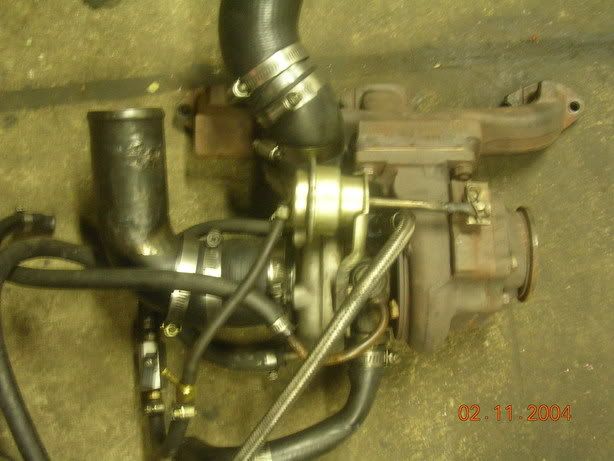

Is this the enigne your planning to run EFi on?

what`s with the ball valve on the boost pipe ?

jimmy, the ball valve is for adjusting the bracket where the needle valve will adjust in. i.e. set the ball valve so i can then adjust the needle vlave to bleed boost from 10 to 15 pound or set the ball valve so i can adjust the needle valve to bleed between 8 to 12 pound etc

ok,well finally i was able to change my cam from the Ph 3 to an OZ design turbo cam, not sure if many of you guys have read the name Graham Russel in mini magaze at all but he is the mini guru down here in OZ and he wanted to help me out with a new cam after the dissapointing results i got with the Ph3, n e way he designed me a new cam with 112 LCA and 290 lift and around 265 duration, i also fitted my 1.5 solid minisport rockers too and put it back on the dyno and we got some great figures.
as you know the last cam had nothing below 3500rpm and still just did not go as well as i thought it would have.
so now on 13psi i got 175hp at the crank @ 7000rpm and it was still climbing, we did not want to rev it too much harder as its sill freshish but not super fresh and we thought we might spin it up harder once run in more and then on a chassis dyno.
the engine made over 110nm of torque at 3,000 rpm and then just climbed up and up.
so i should try and get the engine in this weekend and let you all know how it goes.
