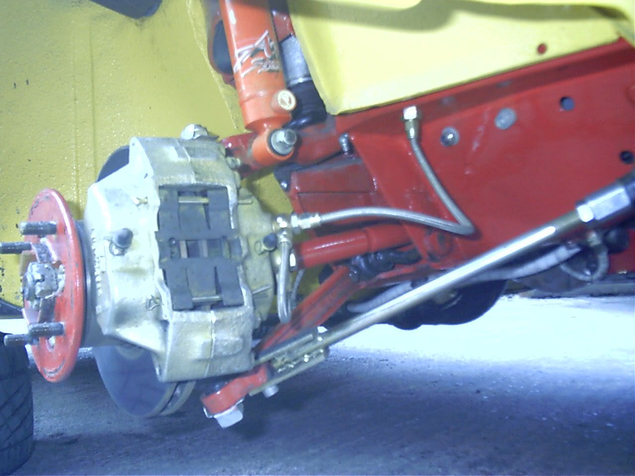

ha forgot about this thread, how did it go dave. Hes a pic of mine from a few weeks ago:
