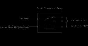

A far easier way of doing this is to just use a 5 pin changeover relay, and the standard oil pressure switch that triggers at around 5psi.
If you wire it up in a certain way, you can have it so that when you turn the ignition switch to "crank" position, this primes your fuel pump to allow the engine to start, then once the oil pressure has risen, this switches the relay over and allows the pump to run as normal. In the event of loss of oil pressure your fuel pump stops.
This is how the Metro turbos were originally arranged.

This is how to do it with a relay if anyone is interested.
