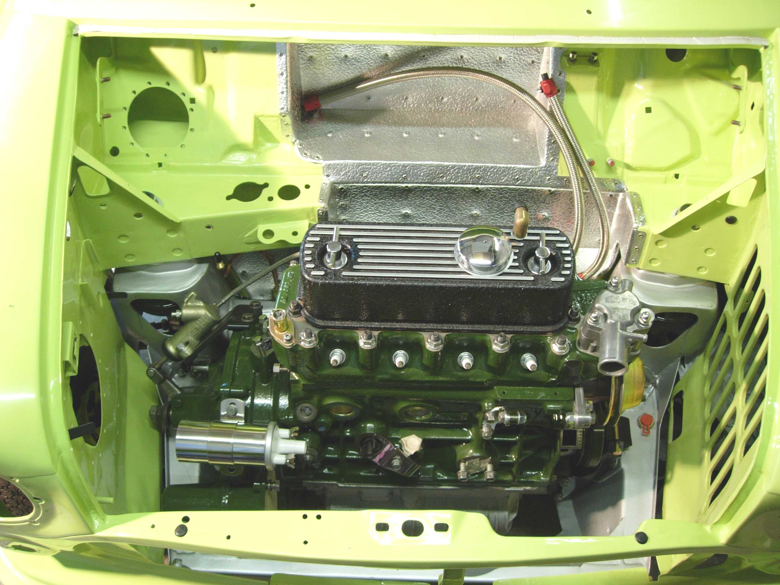

cant take the credit for it, freind of mine cut and welded it in, its an avonbar box. When i put the engine in is when i realised just why everyone makes a fuss about the diagonal section - the space is pretty tight!
After I had to revisit it to cut the corner off as the air pipe would not fit......

do i get a prize for digging up a 3 nearly 4yr old thread :p
I looked on this site for ages for box photos and most links are broken, so its only fair I now make my contribution after fitting it this weekend.

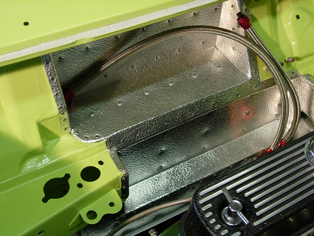

Slightly different approach :
Weber air box and a 3 inch extension fitted to an Avonbar bulkhead box.
Don't be fooled by the pop rivets, it's all seam welded then fitted with a layer of flame retardant material and covered in ali sheet.
Loads of clearance around the actuator and inlet hose.
