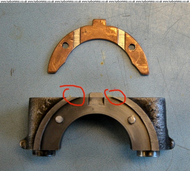

Below is a picture of my centre main cap which has been machined for a strap. The problem is that, unlike 1275 caps, when the cap is machined the locating slot for the thrusts is machined off. It is apparently common practice to just use the thrusts as they are and let them float around a bit, but I have done this in the past and wrecked an engine.
The problem is that the sharp edges (circled) can knock the locating tab off the thrust washer causing it to spin round, this obviously wrecks the block and cap.
As a result of this I now have my thrusts and caps dowled as shown. worth doing IMO.
Looks a good solution, when I built a 1098 based engine for my road car some years ago, I got my mate to machine a small recess in the strap itself for the thrust washer tab to locate in, worked a treat. I also got him to machine a flat on top of the strap, so I could still use the original style locktabs too.

Your strap is much wider than mine, meaning you can machine in a locating groove.
The dowells seem to work fine though, cheers for the offer though.

This is how Simon has done mine:
Muts nuts.
Just like mine *wink* However, I did file the grooves. That took bloody ages.

I think he hhad these made after I told him that the way he did mine was a recipy for disaster.
That looks like an excelent solution.
