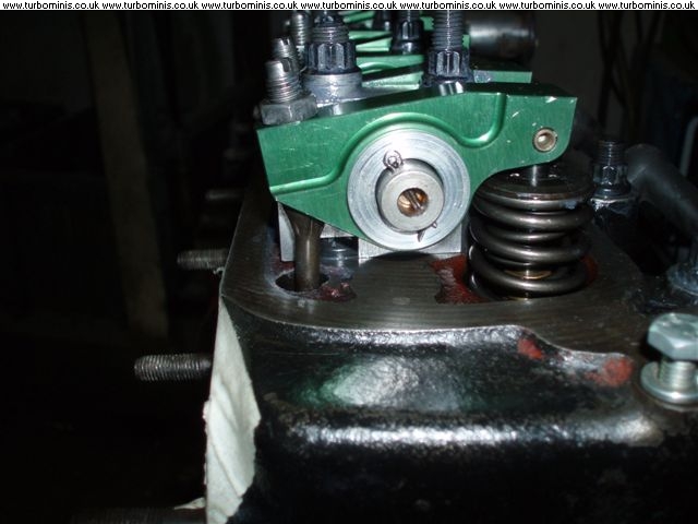

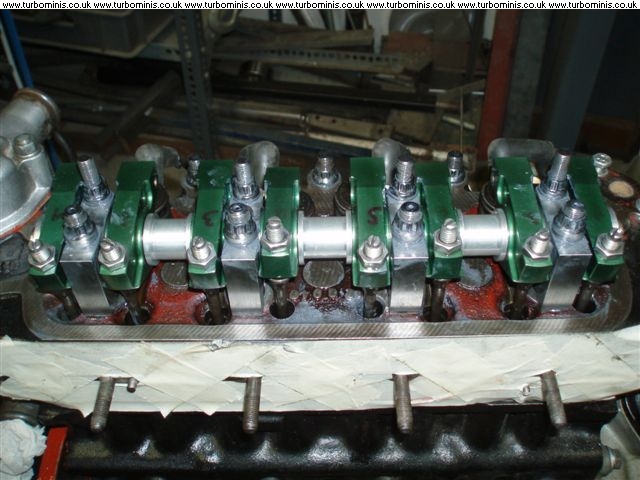

thats a cracking idea if your changing rockers a bit for testing.
AV-R Technologies
198 Posts
Member #: 345
Guildford Surrey
Hmmm yes looks good. I don't like the angle those rockers are sitting at.
http://www.avonbar.com
Why? Isn't that perfect?
Makes re torquing the head a little awkward.
What are the studs?
Paul
TurboHarry
263 Posts
Member #: 115
Austria, near Vienna

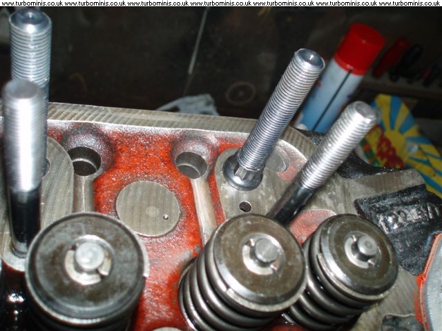

The studs are selfmade from 42CrMo4 in conjunction with ARP nuts. Made the 1,5 rockers with the same principle, so I can change them easily on the dyno. With my ARP stud kit i found out, that when I tried to retorque the studs that my gaskets didn't settle; the nuts cam to the same position. (After loosening them a little of course)

Great Work harry... I also suspect (especially given the nature of the person) that the geometry is fine.
Perhaps you can clarifyu this?
As ever - I'm in awe of your work!

I took the photos just to give an idea about the idea. At this stage of building I haven't checked the geometry yet. Has to be done of course.
