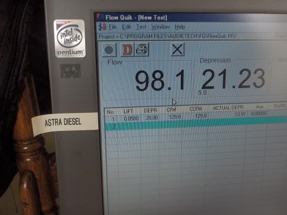

in theory ,(if iv not made a hash of this photobucket stuff) ,! heres some flow test data on a couple of intercoolers ,one rs ford ,and the other an astra diesel one . genarally you need 150 cfm per hundred bhp, before restriction over 1psi drop occurs.dont know if this is interesting to you all but thought it may be .regards ,robert.
20test/flowbenchintercoolertest.jpg[/IMG]
