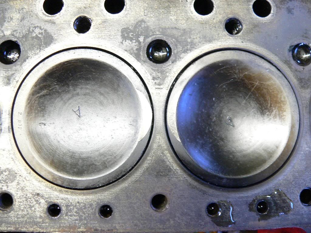

i looked at my engine today, pistons 2+3 have had valve contact its very light and you cant feel any damage to the piston when running fingers over them
im shitting a brick now! this was with mg cam and 1.5 rockers, my new build has about 10 thou less on the piston to deck height and i am now running a ph2 cam
is there any other reason for this? scattered timing? my setting tappets wrong? overrevving? there was no contact evident last time i lifted the head
does this mean i have to get pistons machined?
there is also cracks between 3+4 just evident in the pic, i am not bothered if this engine is scrap what i am worred about in the new engine will i have to go back to mg rockers? with the ph2?

How the F**K have you managed that on an A-series???
This is not possible as the valve has to lift at least (assuming a VERY skimmed head) 5mm off the seat before reaching deck level - and I don't know what cam can do that in the 50/60 degrees before TDC that it starts to happen - unless your cam timing is a MILE off ????
its possible dave i did not do the engine bought as is, its got steel lightened duplex gears and is clearly lightly rebuilt
would it not run though if the valve timing was out? it drove reasonable

Is the timing chain still on to be able to check?? Seems very strange

piper reccomend standard or 1.3 ratio rocker with the phase two.

I have a NA engine with std pressed steel rockes (highest lift) STR930 cam, and 13,5 cc head(skimmed lots), pistons flush with block deck. with this setup I am still 1 mm clear from the pistons with the valves.

pistons may be ok , mine has had a bit of contact but that was through over tightened tappet when adjusting for the first time but it did just mark it rather than when running.

yes mat i will get the cover off in the morning

Between 2 and 3 is the hottest part of the engine,if cooling is a bit lack could be the valves sticking a bit in the guides

I was going to sugest this too. if igniton timing was out, then it would get hot and th guides could nip up a little.

i concer as wolfie told me that it was just 2 and 3 which was marked so sounds about right.
i will go with valve seizure in the guides on 2 & 3
Created by fueling & or ..Ignition timing, too HOT! *frown*
for me the piston on the left shows signs of detonation and is starting to break up!
i would not trust these further IMO.
the above needs addressing on you next build. *smiley*
what guides & valves were used wolfie?.

I had an exhaust valve pinch up on me. However the damage I got was much more severe (bend valve and very dented piston)
It would be well worth checking out your valve stem to guide clearances and making sure they are not too tight

Garranteed seizure, make sure those guide are well reemed especially if they are bronze.

yes they were tight on the reamer but didnt seam to bad with the valve in but should be ok now as long as that fuel and ign is correct.
