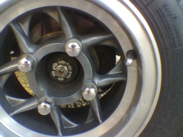

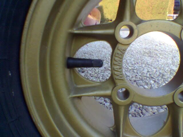

You dont happen to have a picture of the difference do you?
Manchester Minis
Old boys:
New boys
OOOH now that IS interesting :cool:

hmmm i only speak from my experience
the ones without cast in mamba are remanufactured ones from a few years back, the other ones are much older
the grey ones fit over 4 pots, and are the same as the ones on that car for sale
and the gold ones have no chance
