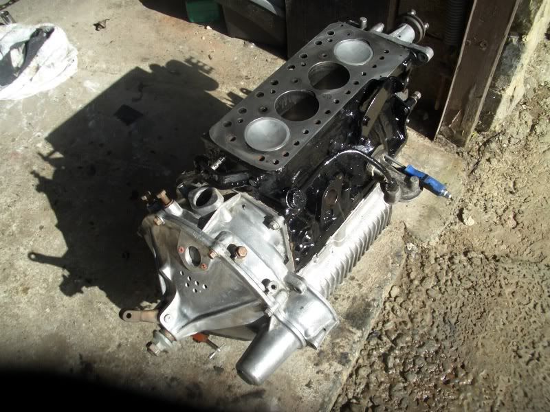

Heres a photo from today...
are the engine mounts next?
oh...no, that would be the brakes!!!
