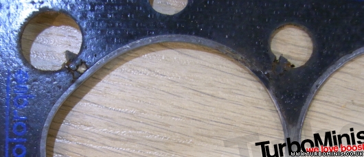

After lunching a copper gasket when I had boost control issues and lots of det I put one of the black ones on, this was just before Le Mans. I was running around 8psi, no pinking, no overheating, a nice relatively unstressd life for a head gasket. It then failed catastrophically. You can see the photo below.
Now, it has to be mentioned that I had torqued the head to 68Nm (as standard) but the gasket packet specified staged torquing 20Nm, 40Nm then 54Nm.

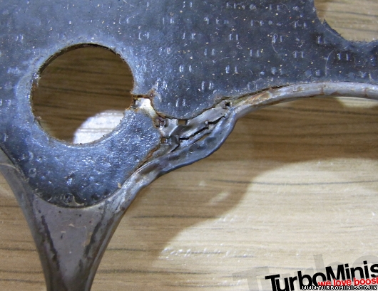

The following photo shows another firering with damage and likely to fail soon:
I therefore put this failure down to me over-torquing the gasket.

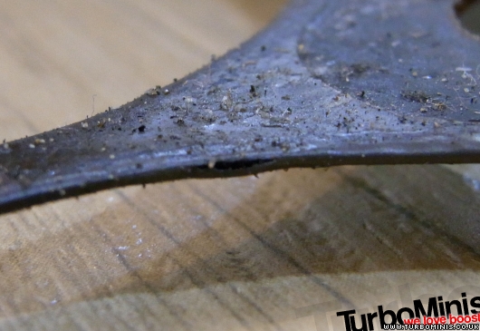

So, on to the second failure. This time I torqued to 54Nm in stages as specified. The gasket failed, with a leak from cylinder to coolant, see photo:
Now, having experience of this type of failure I know it's owing to under-torquing. I calibrated my wrench last month by the way, but it's unlikey to be high at 68Nm and low at 54Nm in any case.
