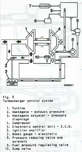

hi all where does the actuator pipe go after its goes to the turbo, cuz there is still a length of pipe after the turbo. and im guessing my bleed valve goes between the actuator and the turbo.

Is the pipe from the turbo the pipe from the metro ecu ?
from std set up ?
1293 Turbo mini

i think so i didnt take it out of the metro so i dont know, thats the only place i can think of it going though. should i just blank it off?

It goes to the electric bleed valve,If you blank it off you will only get 3psi boost as that is what the actuater is rated at.......If you leave it open you will get lots of boost as the actuater won't open at all.
You really want a bleed valve on it to leak 4psi so you run 7psi
or block it off and get a 7 or 8psi actuater

ive got a -31 actuator on it so thats not a problem, and im going to have the bleed valve so i can adjust the boost, i just want to know wot to do with the other pipe .

Just block it of then
