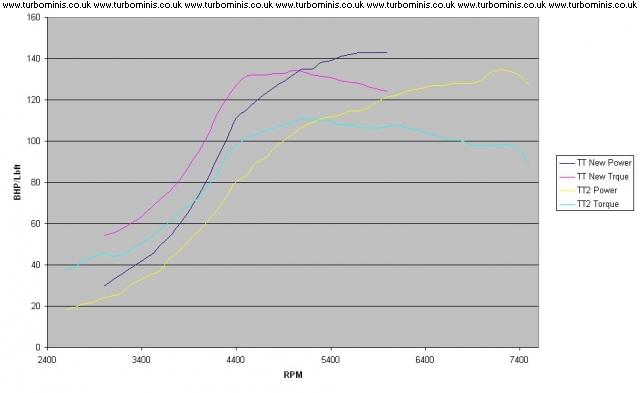

The basics of it are that it made less power (130 compared to 140) at a higher RPM (7200 compared to 6000) with less torque (110 compared to 134). It also made boost only slighty earlier in the rev range
And to cap it all the head gasket blew, not sure why.
I'm going to fit the old head later, but stick with the T2 for the time being.
Bugger, bugger and bugger again.

I'm not sure all is lost. I would like to see the plots of power and torque overlaid from the old engine before I come to a conclusion.
Look at it like this. If we have 110lb (ish) from 4000 - 7000 insted of 135lb from 4500 to 6000, even though the peak figures are down the spread is better and could work on track. I would like more and it is always a development so I am thinking stick with it for now.

As if by magic. That is pretty rubbish in my book

I'll do an overlay of the Metro T3 and R5GT compressor maps tonight and see if there is anything obvious.

wil ,was this the same dyno that created the other figures? is there any chanve of a dyno mis calibration for yuor rpm ? also ,from the blown hg ,poss detonation ,is the timing at all experimental ?all usual q i m sure yuov thuoght of ,fuel octane ,compression ratio, mixture etc , what cam duration do yuo have in it ,and whats it timed in at ? hope this helps good luck ,chin up chap .regards robert.

I think the thing you need to understand about the reving is before we had a standard (opened out combustion chamber) MG metro head which was the restriction. Now we have a well flowed head. I was expecting it to rev longer purely because of the head. It looks like the head could be causing problems low down because the ports might be too big, hence the T2 looks slow to spool up.

OR stick the T3 back on... You can see how well matched it is to the small 998 like yours from the diagram peter put up...
