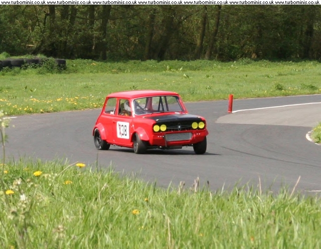

Here is me:
And here is Wil going sidways again:
Wil turns into corners much harder than me and was affected by the oversteer more I think. Well that could explain why I beat him by a bout a second, something he forgot to mention. Another thing that came to light was that the rev limit was set to 6800 so that is why the power drops off on the RR after that. A bit of setup and bits and bobs should see it as a flyer.

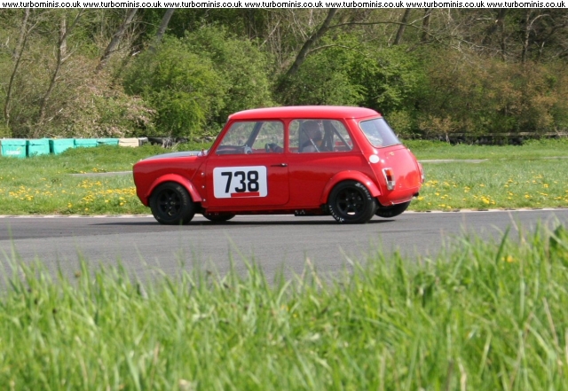

Seems to have a fair bit of body roll, are you allowed to run antiroll bars?.
I am sure with some suspsion geometry tweeks it will all come together.

We've got the hardest rubber doughnuts known to man on the front and it still rolls. There is an ARB on the back. Maybe a front one as a future mod.
It is actually very controlable, and we don't want to dial out the oversteer completly as it's great round the slower corners.

It is amazing from pictures how much a car that FEELS very flat in cornering is actually rolling when you capture it in a static photograph.
I'd personally be looking at the rear toe settings as a starter for ten, I won't put any more detail up here as I am sure you guys know which direction to be going in with it. Possibly a change to camber settings with the slight roll it is displaying in the pictures may be advantageous as well.
The reat toe is currently set straight ahead. and unfortunately, for whatever reason, this is as close to any toe-in that can be achieved. I'm suer that we CAN get more but it'll involve changing the brackets I think.
Raising the rear is what we are planning, this can have dramatic affects on undesteer/oversteer.

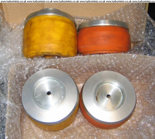

Are you using rubber still or poly? I have heard that the super hard MS ones are not super hard and this could be your problem.
I had a severe oversteer on the first corner at Curborough but this was cured by poly springs.

I've got a set of polly springs in the garage. I bought them second hand, so I'm not exactly sure what I have, anyone any ideas?
Any way I fitted the smaller ones to the front and a 'jump test' on the subframe led me to believe that they were softer than the rubber donughts I have.

I would get the shore hardness tested - these are not the same colour as my poly springs - there are two hardnesses available 80 and 95. 95 is too hard unless pure circuit use
