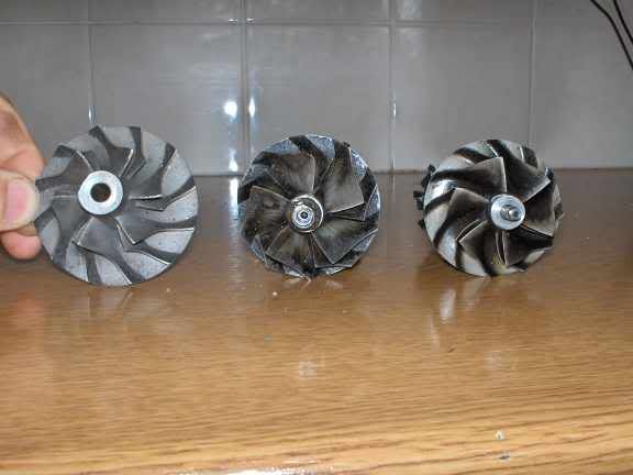

here a t3 40 trim and a t25 and a gt1752 side by side the gt17 is the lightest and most modern they all flow in the 100 to 210/230bhp ish bracket.notice how the gt17 intermediate blades are curved .

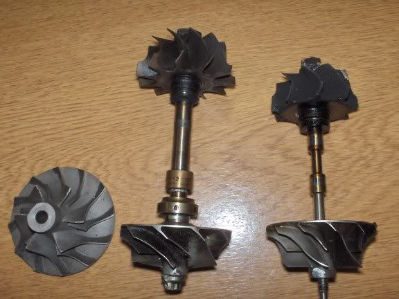

next you can see the difference in weight and so on in the comparison between the t25 ,and the gt17 shaft and wheels this and the blade design and housing is what makes these gt turbo capable of up to 80% eff.

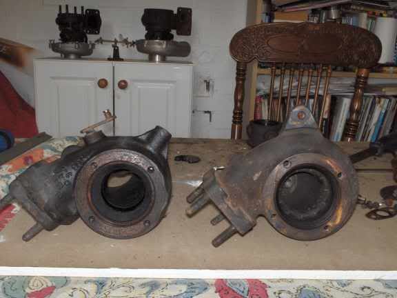

and these are the gt17 on the left .47a/r and t25 housings a/r .49. i think a gt17 may just be a stonker on a high hp min .regards robert.

look at the size of those turbo's in the background on the white unit! What are they from??
HUGE!

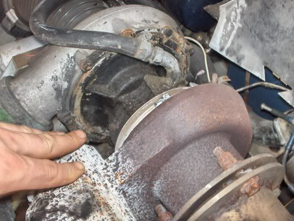

well spotted jimster lhs is a kkk k26 hybrid with a 58mm inducer wheel in place of the original piffling 45mm wheel standard on a rs2 audi,ran up to 43psi *tongue* the rhs one is an original rs500 compressor wheel and housing on a t35 modified turbine ,you think these are big check out this pic of the one on my other car
6753 Posts
now THATS what im talking about.lol..you should hear that bad boy spool up guaranteed to swivel all the heads at santa pod on the burnout wheel spin and back off up to the line. yep thats a 4'' down pipe.

its on a 3.5 litre rover v8 peter.
