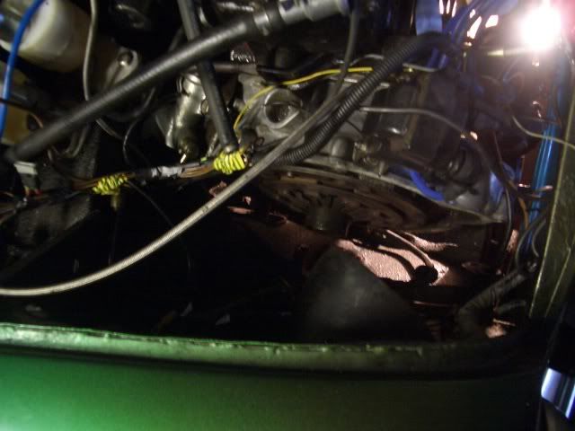

not really relevant but pic before i pulled the flywheel off it!
