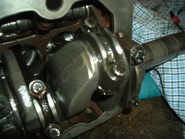

Took engine out and apart again, heres what i found...
Luckily just some very light scratches on my crank so going to continue to use it. Ive got over £900 of reciepts for just the machining that was done on the engine before i got it from pot_dan including loads of lightening ballencing and whatever else was done to the crank, guess its not so balanced anymore!
Got engine back togehter now just got to put flywheel on tomorow afternoon, put it back in and hopefully get it running again!
That was almost an expensive mistake!!!

have you cleaned out all the oilways and the sump dude? there's going to be some big chunks of dizzy drive teeth knocking aorund somewhere!

Just out of curiosity, how has this happened??
Are you using Megajolt and left this in without the dizzy??

Yep thats what i did! Ive never taken out a dizzy drive before i just thought it wouldnt harm to leave it in there *surprised*
whoops!
Yeah theres no bits in the sump etc it will be fine, im going to do a couple of extra oil changes too when its running again, 3 or 4 of them

if there are no bits in the sump does that mean you've took them out or you never found that many?
because if its the later you may as well say goodbye to your engine now.
£900!!! bloody hell, what was done???
iain is right, you have GOT to find ALL the bits missing from that dizzy drive! When I stripped the diff planet wheels on my autograss car a few years ago, I stripped the diff, counted the gear teeth I was missing, and then washed the box out and delved around with a magnet on a stick until I was certain I had ALL the bits out.
have to agree
personally i would have my local machine shop clean it out properly, much cheaper than having crank reground and new bearings, followers and poss cam

Yeah got everything out, will give it a really good flush through with a few oil changes too everything should be fine

ill get out the reciepts later, there was so much stuff lightened on it, also something was done to the crank i think, some sort of coating on it. Ill find reciepts when engines in
personally i would not want to chance any debris floating around regardless of the oil changes planned
the the guys says feebs you have GOT to account for "ALL" the bits which was lost from the drive gear!
are you SURE!
feebs seriously this aint good enough imho as the damage will occur before youve done the first oil change. these fragments small bits could knacker things up. this is similar to what killed my last engine on mine my diff pin worn badly and the swarf killed the oil pump which led to no oil pressure on start up for ages which killed the cank bearings.
yeah you might get away with it but we all might be saying told you so!!! in a month. its your call
I get the feeling we are wasting our breath lads.
I hope it is OK for your feebs but from bitter experience I suspect this will come back to bite you in the arse......

if im wrong then somebody please correct me but that crank doesnt look lightened to me*frown*

easy man think of everything the oil is lubricating and protecting, you could totally fuck your whole engine, and the turbo unless you get it totally clean.
4641 Posts
Yep got to agree with the above. It's pure stupididty when you've put so much time effort and money into the engine not to spend a bit more time making sure you've removed all the swarf.
On your head be it ..........

pulled off the box again tonight and checked again everywhere for parts i gave it a blast out with the jetwash hope its ok to do that?? No more pieces of metal anywhere though just clean water coming out.
bit late asking if you have already done that
have you re lubed the cam?

Need to get another gasket set, is it worth getting it chemically cleaned out? I dont know anywhere local and i sold my jeep to get new master cylinders lol so no transport to get there!!
