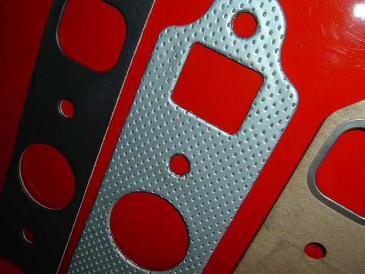

I orded some head gaskets from mini-its in the week, and id been having some trouble finding a turbo manifold gasket, when he said he had his own type of gasket made up, interested i said id take a couple to try.
So what do you chaps think of this? (its the middle one)
ive tried an injection one before but i ended up with it blowing, the turbo one this year has been ok over the last 1164 miles
he said its made of the same stuff as the K series ones, and appears to be a gasket sandwiched between 2 layers of thin aluminium
my only worry is that it doesnt have a ring around the inside of the exhaust like the turbo one does, but then again if it doesnt destroy on a nasp car turbo exhaust heat wont be that much hotter will it?
I've used this gasket before on NA stuff a few years ago, had no problems with it. See how you go with a turbo I suppose?

been fine on my car, and on antons N/A aswell.

I found the exhaust port holes a bit small on the perferated one for my head,so will need trimming a bit

my be ok ive just ordered one from avonbar so well see what it looks like. the only thing with the middle one i can fink of is them types off gasket tend to stick to the surfaces of the head/manifold so should you need to do a quick head gasket change at avon youd probably need a new gasket there as well. *smiley*

yes the exhaust ports are a bit small, and need a little opening out
Not having done much on turbo's i dunno but,
isn't the turbo gasket only available in one size with the reinforcing ring?
assuming this the ring will be lost when opening it out to suit a modded head.
...so this (minits own) gasket should be no worse than the proper one.

the ring is a fair size mate, opening up your ports bigger than it is fairly hard...
Ive tried min-its style ones with no luck at all, the origional metty turbo one really is the nuts, i wish i had some spare in stock

i know my morspeed was opened out and matched to the steel rung gasket.
That gasket, Ive had similar ones on a NA engine that burnt through the exhaust port at the top when on the rollers, the graphite/fibre was totaly gone leaving just the perforated steel. Will never use them again.

I'm running a similar gasket, but it's ALL metal. I've used this gasket for years and it's the bollox. Last time i found somebody selling them i bought 10.
I saw the one you've got, and it just looked like a normal gasket in disguise, so i avoided it.
If you're desperate i can send you one of my proper ones ?
Phil. *smiley*

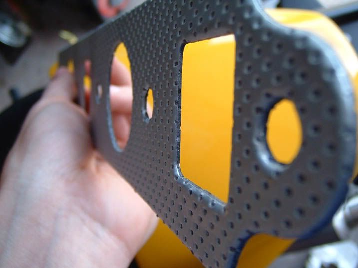

do you have any pics phil?
is it loads of layers of steel foil?
I've never had any luck with that design on nat-asp motors.

4641 Posts
It looks the same as yours, but it's all metal.
Phil. *smiley*
all the way through?
4641 Posts
Yep !! *smiley*

looks like a minispares c-aht381 gasket to me..
