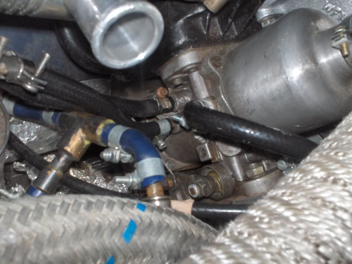

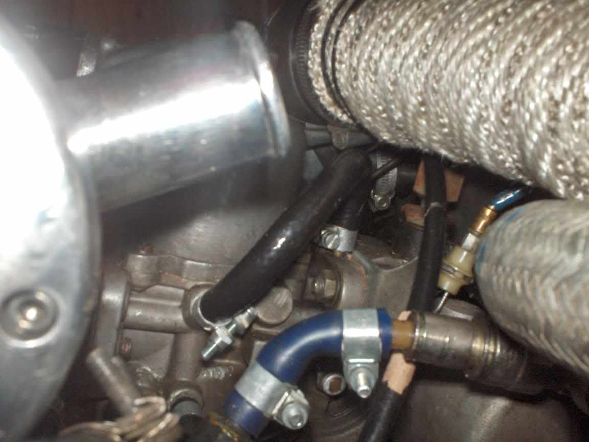

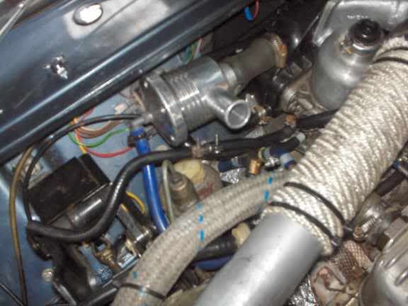

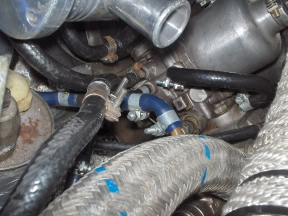

hers a few pics bit messy hope they make sense!
the original idea was to run a free flowing one way valve then a pipe to inside the car with a variable valve on it and adjust to get the right mix ,so varying the vacuum over the float bowl ... in fact ,the tyre valve ( this is necessary to stop boost blowing out of the pipe) seems to make the correct amount of restriction for MY engine and needle combo !!
this may very well be diff to any one elses. so better to use a big one way valve ,and an adjuster really , to cater for other designs .
be very carefull not to run lean at part throttle with a few pounds of boost ,that could be terminal *tired*
use a lambda preferably a wide band .you deffinately dont i repeat dont ,want to run anything other than good and rich on a a series under boost eg 12 to 1 cos their a bit fragile ...preach preach ouch splinter in my foot from this soap box ..*wink*
regards robert
