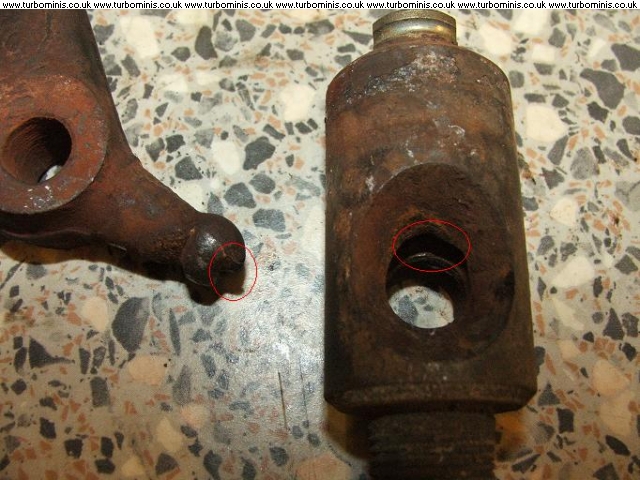

Try lubricating the pedal! WD40 and work it back and forward a bit!
plunger worn or seized in the wok???
Edited by Sprocket on 6th Jul, 2006.
As tom says, but try lubricating on the clutch boss, "big nut" where it pivots in and out alex
usually it siezes there, pump and lube there

those pics are it alex, which mini sprocket posted get the oil can in there

I was under the impression that the diaphragm did the pedal return thing???? the sprign was just a helper.
Still reco you'll find the plunger and arm worn as above. That was off a 92 Cooper so not that old. Incidently the release bearing had also seized and worn the thrust sleave and verto diaphragm fingers, the whole clutch was pretty much bolloxed.

on the bit pictured above? grab me on msn mr legend
No - he means on the pedal box itself... This is whee your problem lies, NOT anything forwards of the pushrod.
