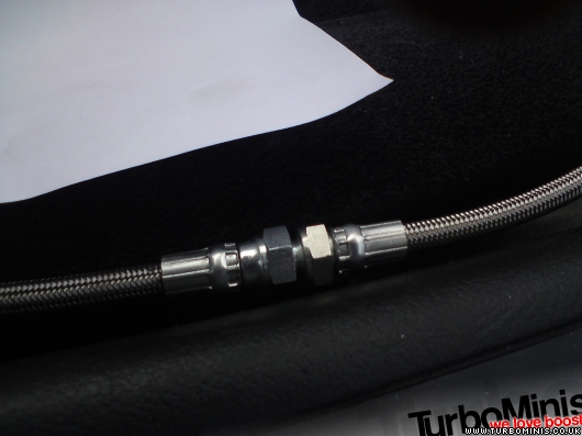

Went down to my local hose specialists and came out with this:
Came to a whopping £2.08p RESULT!
So i'm pretty happy now, off outside I go to try and get the thing started!! :)

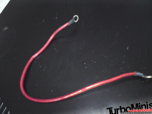

I found this earth strap, would you say its man-enough for the job? (block to bollockhead).
