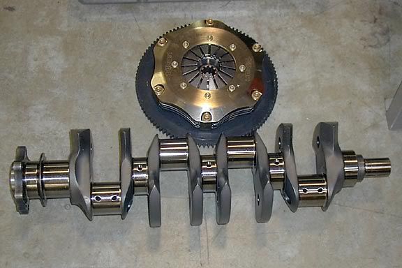

As title, curious, not seen it done on A/A+
Paul
No, Ive done, wedge, blade, backdrill, but not seen knife edging which is supposedly for aerodynamics. Swifty spoke of it a few times

blading is knifedging as far as i was aware,

No, its on the leading edges for aero. Ive seen it on a crank for something else

i thopught that would be what you were refering to,
all my cranks have an almost full radiused edge to the web, none of that rough as a bears arse flat left when its somply milled off and had a very cursory clean up of sharp edges,.
You can see it on this crank on the leading edge of the counterbalance

this v8 crank is supposed to turn in a bath of oil, so the knifedging is there to reduce oil/air mix, and oil resistance to rotation.
a mini one doesn't , could be usefull on a midget a serie, but don't think it will help on mini, that said it's a beauty!
The text that came with that pic said its for air resistance. Im sure it wouldnt be sitting in the oil

My understanding of this is that it cuts through the air and oil, so as you say resistance therefore there could be some gains along the way

I think that you could have imagine, that if you're not using dry sump then,
your sump look as a bath in which oil is carried,and canot stand all time in bottom of it( corner, acceleration, braking... racing what!!! isn't a lot of engine are built like this, then the interest of knifedge is to cut the oil/mist instead of hurt it,
canot be more explicit,
as for 'air' cut, think of your pistons going up and down, your knife on the crank will gain about nothing in air, this is the raison why it si generally not used on dry sumped engines.

Blading an A-series crank...NOOO
Is that just because it loses counterbalance?
Exactly. Great for drag racing, stupid for longetivity. Horses for courses!
