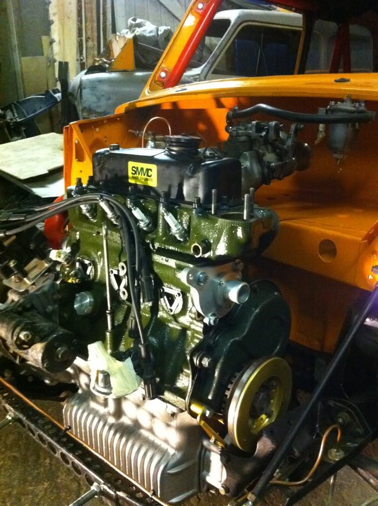

clubbie70
190 Posts
Member #: 8935
netherlands

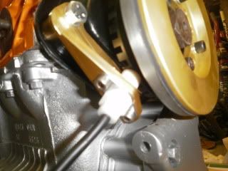

clubbie70
190 Posts
Member #: 8935
netherlands
had to modify the bracket though so tha the missing tooth aligned with the cam on the breathercase
Rick.SPI
1596 Posts
Member #: 8027
I was looking into getting this damper, but i don't like the sound of modifying it. :s
clubbie70
190 Posts
Member #: 8935
netherlands
i did only some minor modifying to bracket
1380rich
484 Posts
Member #: 4755
warwickshire
Mine went straight on, are you using the med trigger wheel pulley?
clubbie70
190 Posts
Member #: 8935
netherlands
yes :)
nibble36
116 Posts
Member #: 4273
stoke on trent
mine went on no probs no mods only to remove the tooth
rich are you scared a core plug may fall out.
1380rich
484 Posts
Member #: 4755
warwickshire
Lol I seen them on one of my engine builders old blocks and said they looked pretty cool... Picked my motor up and he'd put them on :)
