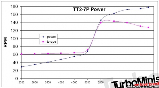

Just got back from the rolling road with the TT2-7P. Wil has just left mine and will be back home in a couple of hours with all the details, but until then what do you think?
I should just say that all went well the only problems were a loose boost pipe and a gear selector problem, neither show stoppers.
Anyway on with the guessing

You're all in the right ball park
Actual figure 178bhp @ 7300
144 lbft @ 6200
This was at 18 psi, the old engine made 153bhp at 15psi, this one made 164 at 15psi. Unfortunately the battery went flat and we were struggling with boost control, a bit of work needed and we might one day run 20psi.

did you fit this at the same time wil?*wink**wink*
was thatstep the result of yuor boost control probs ?

Not sure, but boost wat tailing off and I'm not sure if it was the compressor running out of puff or the boost controller running out of bleed. I suspect the latter, but TBH we only planned to run 18psi.

dont get me wrong i think that power on still pretty low boost is great ,i was looking at your old run wil , you seem to have lost a huge chunk under 5k ,different cam ? still on the gt17 ?
Quite right robert. Everything is the same except the head.
6752 Posts
do you have a data log of the boost we could compare with the nms runs ?

Have you changes Cam timing Will Or compression then engine look like its making real nice power but a bit more peak'e ?

Blimey, good result, that power curve reminds me of the DON, gaining 100bhp in 1000rpm!
