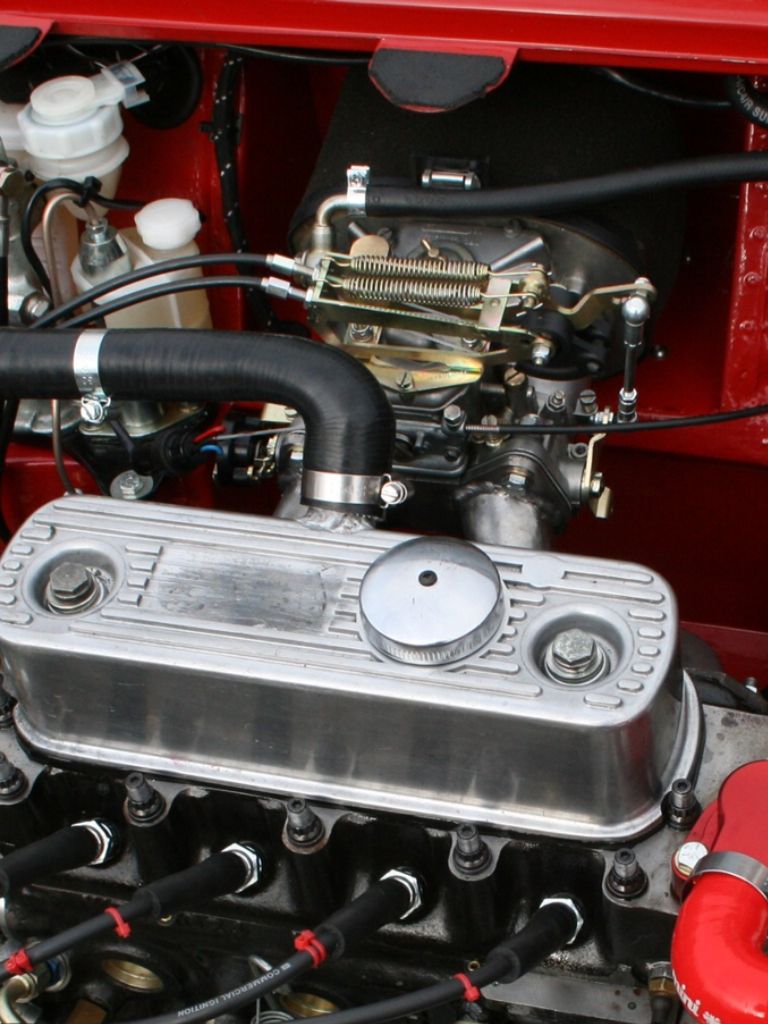

I ran my full race 1380 on megajolt with Weber 45 TPS sensor, worked perfectly at 8.5k. Difference in drivability over a modified aldon red was night & day. Still got the Webcon TPS & bracket if needed.
I had a nice little TPS for a my weber. worked really well.
I have had the same coil pack from the start, its still going strong.

i have mj on my 1330 with a 45 weber with no issues and rev limit is set at 7k.
i used the vacuum take offs and t pieced them together to supply the signal to mj as MAP, also fitted an anti surge valve to carm the signal down.
