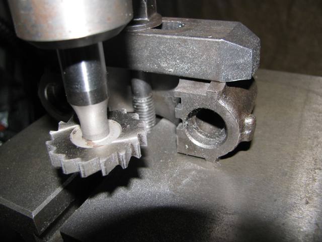

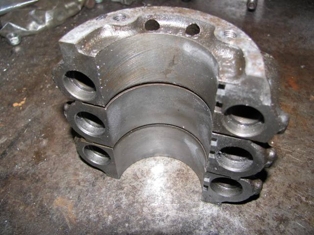

I'm queuing up a big order from Minispares and they are out of stock on the A+ center main bearings. Minisport has the Glacier and Vanderall, any recommendations on the bearings to get?
Also, I picked up a NOS Minispares belt drive conversion kit. It looks pretty nice but I'm heard some mixed reviews on these, should I just go standard duplex and try to sell this?
Edited by seahuston on 9th Feb, 2014.
I used a iwis simplex chain.
I used ACL bearings.
I'm not sure anyone makes performance 998 A+ main bearings anymore.
So I've used pre-A+ mains in my last two engines. However, you need to machine a slot in the cap:
Edited by Paul S on 9th Feb, 2014.

Paul:
Thanks for the tip and the pictures, I can certainly pull that off
