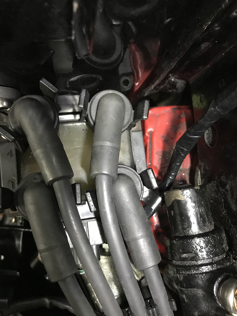

Hi guys,
Edited by chris_rd92 on 26th Dec, 2020. |

Are the posts on the coil pack marked up with n umbers at all?
15 Posts Member #: 12098 Member |
27th Dec, 2020 at 12:23:20am
On 26th Dec, 2020 shane said:
Are the posts on the coil pack marked up with n umbers at all? as its wasted spark you can't really go a million miles out without showing signs of firing? Fresh fuel? Have you put a timing strobe on to check the timing? Shane Nope no numbers at all, I have a feeling the coil may be wired backwards, as any other configuration removes any sign of it trying to fire. It's supposed to have leads 1 and 4 on the right, with 2 and 3 on the left, but I have it the other way around currently. The fuel isn't brand new, but it's no older than a few months at the most, so I figured it would be ok. I may replace it though just to rule that out. Not had a chance to check the trigger wheel or anything timing related just yet, as Xmas has been keeping me pretty wrapped up (no pun intended... or is it). I had a quick look. and noticed a marking on the trigger wheel pully that seems to line up with the missing tooth, no idea what this means though until I can check at TDC. Not had chance just yet to have a closer look at the cams, but I'll hopefully be able spare some more time over the next few days as the Xmas madness dies down. |

Do you know the origin of the coil pack that SC use? Ford?
27th Dec, 2020 at 11:58:53am
On 27th Dec, 2020 shane said:
Do you know the origin of the coil pack that SC use? Ford? How many wires within the loom connect to the coil plug connector? 3? Shane Yes indeed it's a Ford part. It has 3 wires connecting it to the loom, one is live, and the other 2 are for each side of the coil I presume. I have a feeling these may be backwards. |
![]() 428 Posts Member #: 10128 Senior Member Dorset |
27th Dec, 2020 at 02:04:32pm
Could well be right, the two "control signals" govern pairs of plug, which would account for your leads giving better response opposite way round. |

This is the line of thought I was going with, Ill take a pic of my ford item shortly for number referencing.

There is a good coil pack picture on here that shows the numbers, and it looks like the part SC sell.

Thanks for that link metroturbo. That bottom diagram definitely looks like the one I have.
