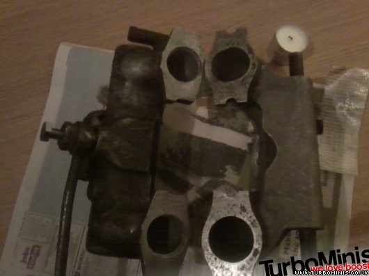

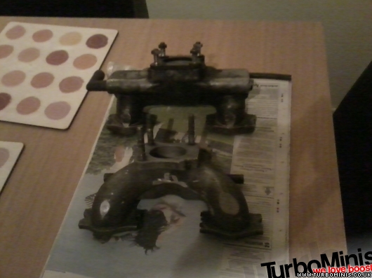

Here are the two side by side. Why don't people use the NA manifolds as they seem to have a larger bore and are have a beak in the middle that can only help air flow?
How thick are the aftermarket inlets?
