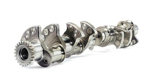

Just got my new crank for 998 project.
![]() 2909 Posts Member #: 83 Post Whore Glasgow, Scotland |
10th Feb, 2007 at 12:46:11pm
On 10th of Feb, 2007 at 12:37pm danboy said:
Just got my new crank for 998 project. What do you think? Anyone care to guess who made it? Regards Dave no idea bit the 3rd and 4th big-end bearigns from the sprocket end are proper fucked and the 1st has heat marks turbo 16v k-series 11.9@118.9 :)
Forum Mod ![]() 5933 Posts Member #: 784 9 times Avon Park Class C winner Milton Keynes |
10th Feb, 2007 at 01:12:32pm
