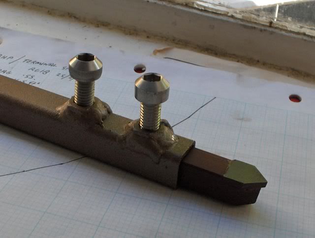

heres the tool i made to get inot the back of the wheel

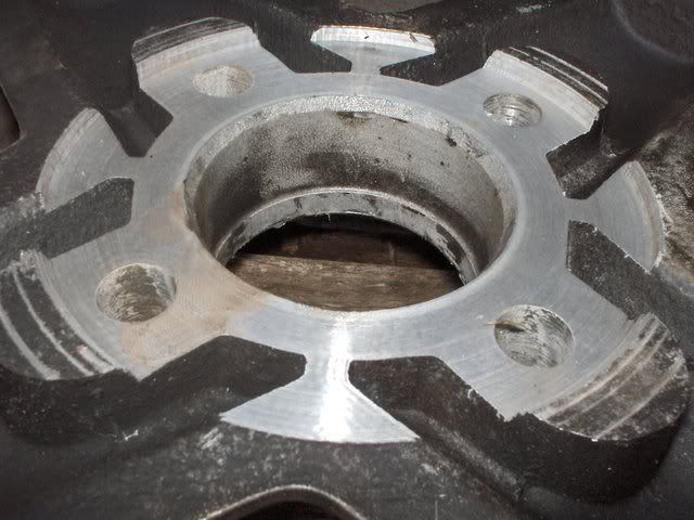

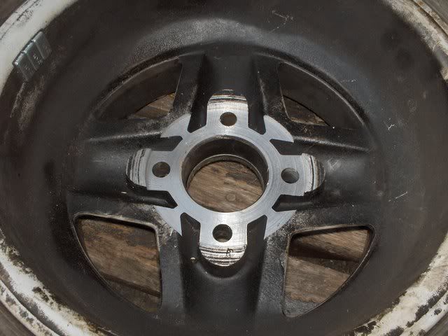

heres a couple of the wheel after 5mm taken off

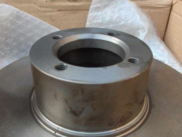

heres the disc with 3mm taken off the mounting flange ,hers a tip ,the brembo discs are v thick in the flange !(calm down nic )

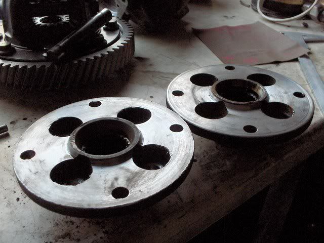

and here the hubs with 3mm off the base and 2mm off the face .

why the 3mm off the disc bell?
Is it to get vents onto mini flanges?
6749 Posts
its cos the hub is 3mm further into the carrier ,otherwise the disc would hit the steering arm ,so it has to come back outwardss 3mm to match the hub going inwards 3mm ...er ..did that make sense .
