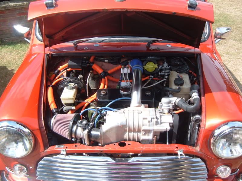

Someone must have seen my M45 setup a couple of years ago and knew how to make it work, well I hope they can cos I couldnt LOL

What couldn't you get to work Eaton_Mini?

My M45 on the front of my MPi engine. More due to a lack of time and manufacturing skills than anything else really. This was late 2005

shame,
looks like a promising start,
i'd say with a plenum and an intercooler and injectors mounted like an spi that could have been good.

Ive still got everything other than the Megasquirt I was using. Once I have my 7 port clubbie running (N/A) Ill be going back to this and picking everyones brains on here about how to make it work properly, although I am thinking of chopping the M45 for a rotrex as thats much much smaller and more effiecient!

Eaton Mini any more pics? I am just at the stage of lplaying around with mounting positions at the moment. Anything that saves a bit of time having been tried before would be good. What was your biggest obstical? Thanks

Lockfast, Im sure I have some other photos somewhere Ill put them up when I find them. My main problem was stopping the belt slipping, I used the standard MPi set up and got a longer belt and a couple of tensioners. The way I had put it all together meant I didnt achieve a good enoough wrap around on the SC or the alternator. Plus I didnt have an IC to put above my rocker cover so that was a solid pipe to start with.
I have learnt by my mistakes though, the only thing that I sold on was the MS2 as that got traded in for the head I bought.
When I re attack this, I will be mounting my SC lower, so it will be at grille height, so that means remote oil filter housing etc etc and also running a dedicated belt rather than trying to do the whole lot off one.

eaton_mini -
How have you mounted that charger? I'd like something like that but still suck through!
Would love a copy of the mounts and alternator mounting..... Would you make another set?
Radleigh: Why would you stay suck through?
For the sake of buying a Turbo carb or converting an N/A for FI use, you could get ride of the worst part of the whole suck through set-up....the suck!!
If your going to the effort of mounting it up the front then make it blow through and intercool it!
see what sort of power these things can make, when properly installed!

I was wondering what the advantage of front mounting the charger is if you're going to go suck through, there surely can't be any?
I'll be going blow through no matter what....
