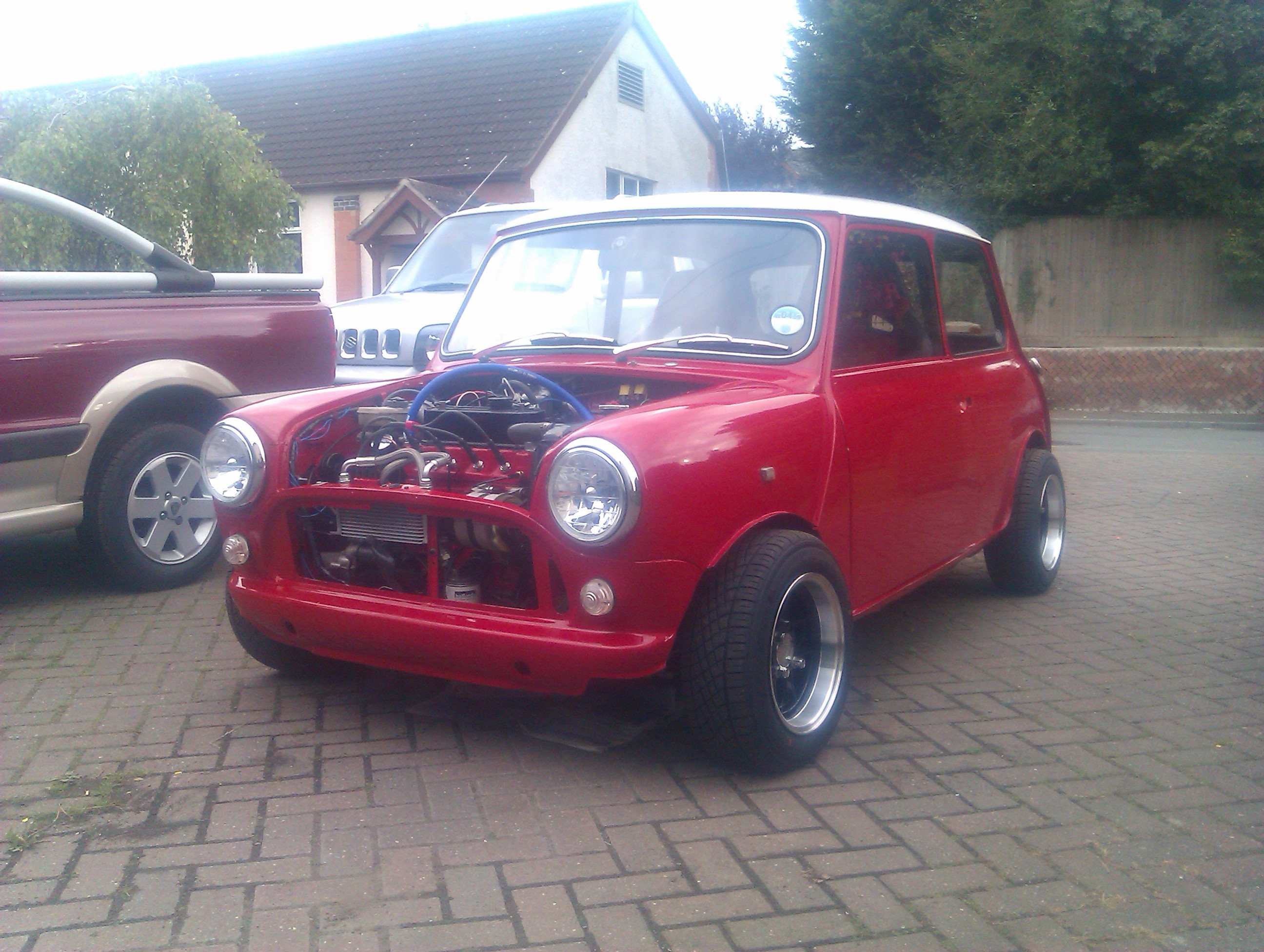

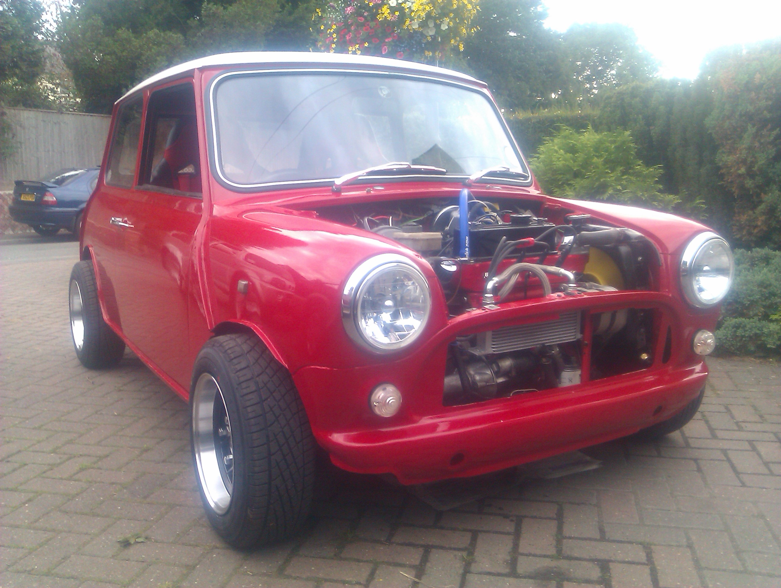

Hi, thought I'd update my thread as its been ages... Well the car was painted eventually, then sent back to be redone after a crap job was done, but that's a whole different story...
It's well on its way now to being completed, had it running n/a, decided to run it in first then fit the gt17 and bits to get it done, but then had a change of heart and bought a t3, just so I could bolt it together without too much hassle and at least run it turbo to get some enthusiasm back!!
Not sure if pics will work but hey!

1293 sprite
536 Posts
Member #: 5449
Melton Mowbray
Pics?

Looking good.
Beno174k
183 Posts
Member #: 9548
Manchester
Yeah mint how do u find the ride on the wheels
http://www.turbominis.co.uk/forums/index.php?p=vt&tid=445578
1293 sprite
536 Posts
Member #: 5449
Melton Mowbray
I've only ever driven a mini on 6x12s so to me its normal, but its always handled well and ride is fine!
