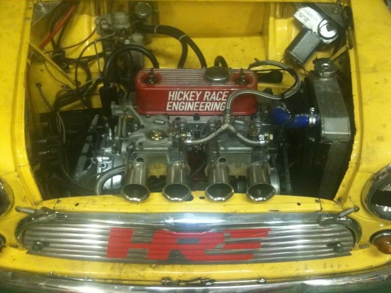

Just a little Pic from the iphone I am waiting on my resident Photographer to take proper photos at track side on Sunday :)

p.s. you've just got to love four ram pipes, sticking out the front of the car.
6753 Posts
yup ,love dello 'webbers ,so masculine .

would i be correct in thinking the ram pipes just squeeze under the bonnet?

Without Filters..? maybe.
Did you run it with a bonnet? The Webers look superb.

They are 100mm ram stacks as we got the highest overall torque figures with them but initially we ran with 60mm stacks and could close the bonnet with ease and plenty of room for socks or K&N s
I have to admit two 45 webers just looks the muts nuts and every one that has seen the car to date says the same the sound from them is quite magical to boot.
